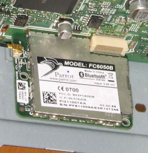

are you using the USB cable into your iPhone or just BT? Do you have the issue with the USB cable?
i had an issue with the HandsFreeLink communicating with my Droid and had to delete the phone from the car's memory and re-connect. That resolved those issues.
I occasionally have an issue where calls are dropped and the HFL seems to struggle with maintaining a connection. I also see this issue with aftermarket radios.
I haven't taken a 2015 apart but this is the bluetooth module inside the 2014 non-touch screen.
Attached Thumbnails 2013 Accord problems with nav. and blutooth-25dd1826-ff22-4e0d-b559-a06a609ce3af.jpg
