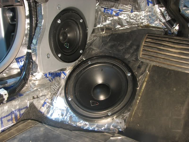

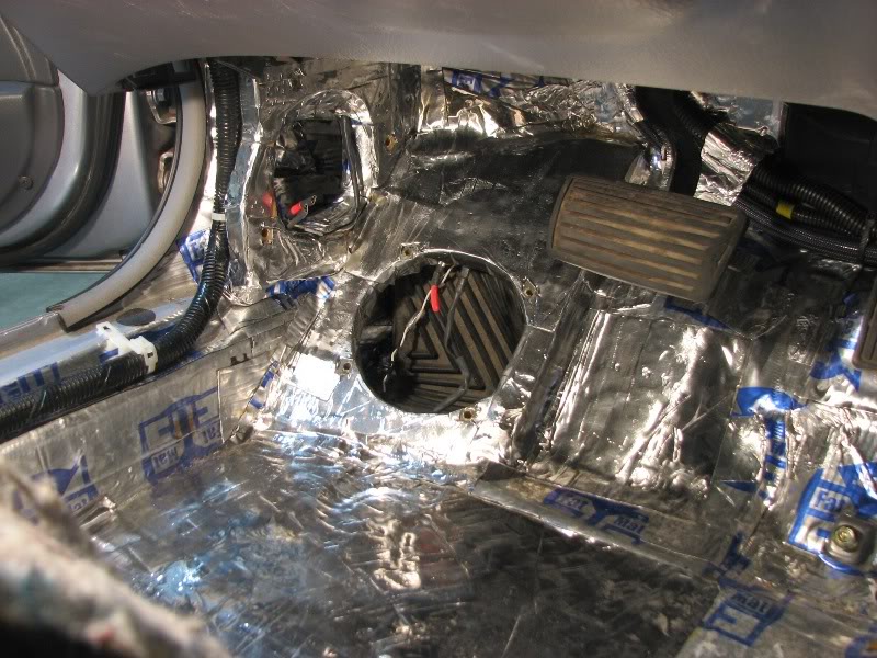

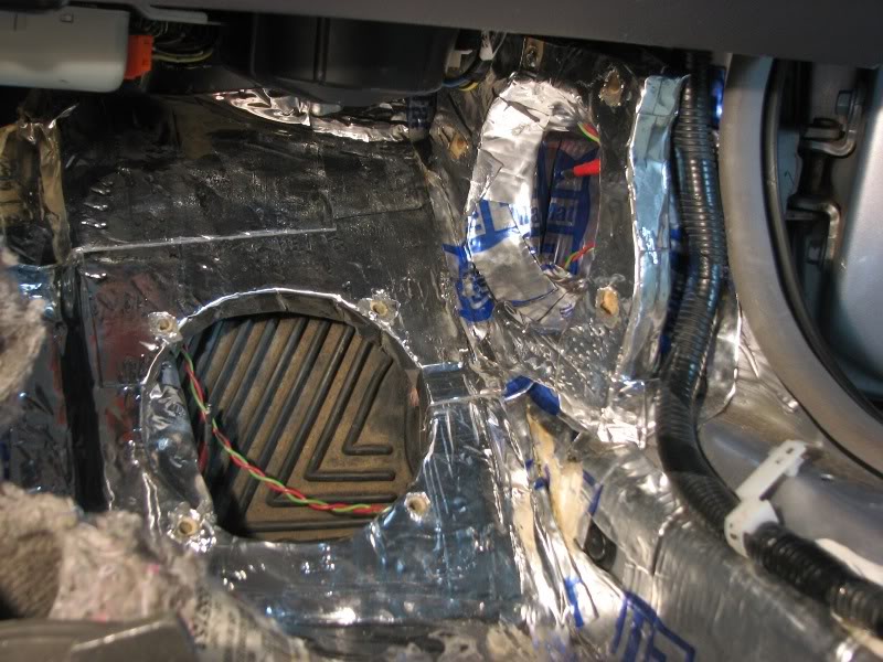

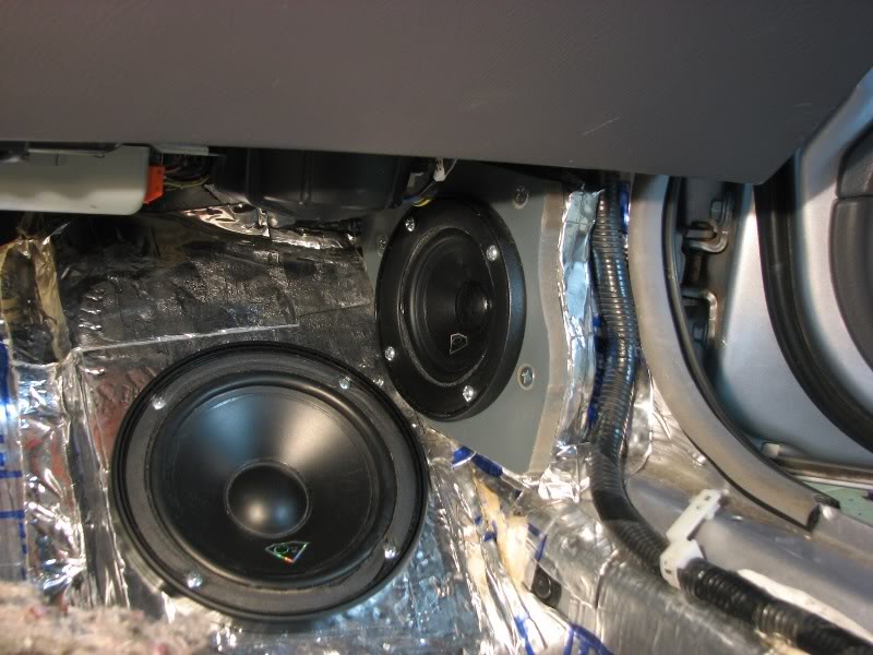

updated images from a recent project with more deadener Raammat BXT II
