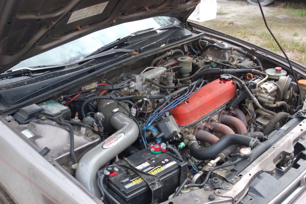

I don't seee why you can't use it on another intake. As long as the pipe is round and the same diameter as the bypass valve it will work.
You will have to cut your new intake tho. you have to make a break in the pipe to install the bypass valve. look at mine....
this is what the intake looked like b4...
that's not the exact intake as mine but you get the idea
