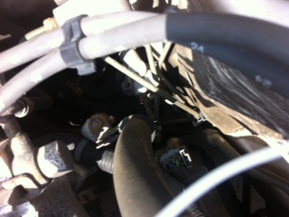

I took a picture and it coming from the part with four brake lines connected to it. It is below all those hoses and it is below the Master Cylinder mounted to the drivers side fender well and I can see brake fluid all over the fender well where that part is mounted too. See attached picture. Does anyone know what that part is?

I think it's a proportioning valve. Which is different whether or not your car has ABS. (Accord LX was available with or without ABS that year)

Mine is non-abs and also could it be possible it is one of the lines going into that proportioning valve. I can see the brake fluid on the wheel well where it is mounted too. Do you have a part number for it?

Seems to me the first thing for you to check is whether it's a loose fitting or something like that, rather than a failure in the proportioning valve itself.
Got a "flare wrench"? It's like a box wrench with a saw-cut through the box. That'll work much better than a typical open-end wrench on those fittings.
