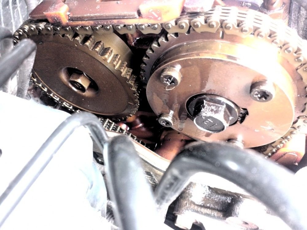

Time to bite the bullet and start the serious stuff! Cam cover off and looking for the marks on the cam sprockets as per the Honda document. Either they don't match or they're 45 degrees out from each other! So here are the best photos I managed to get of the sprockets. For reference, I've included the relevant diagram from the Honda diagnostic document.
Any ideas?

Looking through what I posted, the penny dropped. The problem is a common one: the timing chain had stretched to the point where the tensioner couldn't keep sufficient tension on it (and possibly the tensioner is also on its last legs). And so, the chain had jumped and the valve timings were out.

The coloured links on the new cam chain won't align with the timing marks on the camshaft sprockets. Not both cams at the same time, anyway! If I turn one of the cams to force alignment, it's against considerable resistance from valve springs and, unless I keep tight tension on the chain, it will leap off the exhaust sprocket (because that's the one I "forced", back to the position shown in the photo.
I'll go look again in the morning because the photos aren't clear enough :{
The only thing I can think of is that it's the wrong chain. Anybody got any other ideas?
BTW: I'm posting the details because they may be useful to someone else doing this job for the first time. To which end: It's now clear that it would have been far quicker and easier to get the engine out of the car to do this job. This is not the case, AFAICS, for most Accords but it is with this one! Alternatively, having a pit would have helped :/
The timing marks on the VTC actuator aren't very clear here but they're there if you look hard And they are pointing to the right place on the chain.

So the problem aligning the sprockets was due to me misreading the instruction about "turning the VTC actuator until it locks". I'd been trying to turn it the wrong way Yes, I felt suitably stupid. Turning it the other way, it moved quite a bit and then it was possible to install the new chain with all the valve timing correct. It was still a bit of a forced operation but once I got the tensioner in and unlocked, the chain stayed had put after several crankshaft rotations, so I was happy. After getting some advice from a techie at a very helpful Honda Main Dealer in West London, I proceeded. He said that the actuators do sometimes lock up in odd configurations but once there was oil pressure in the system, it normally straightens itself out. (Long story short - seems that it did )
