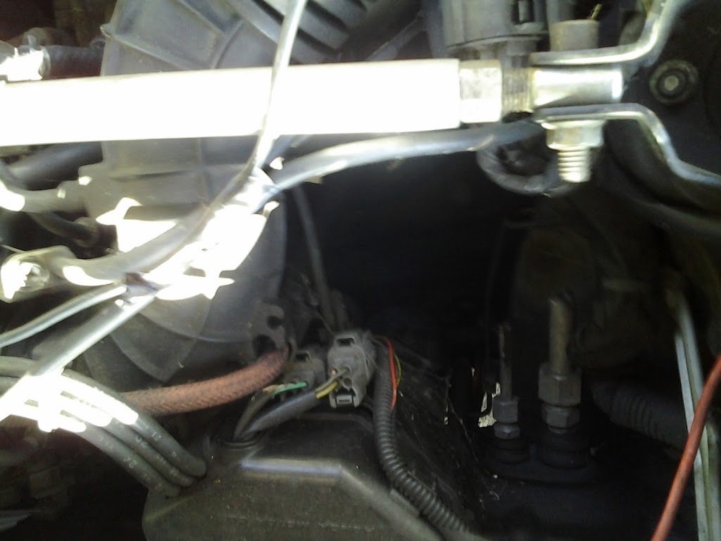

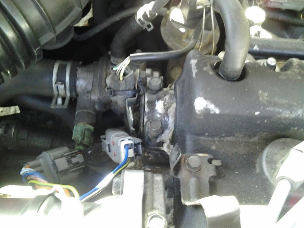

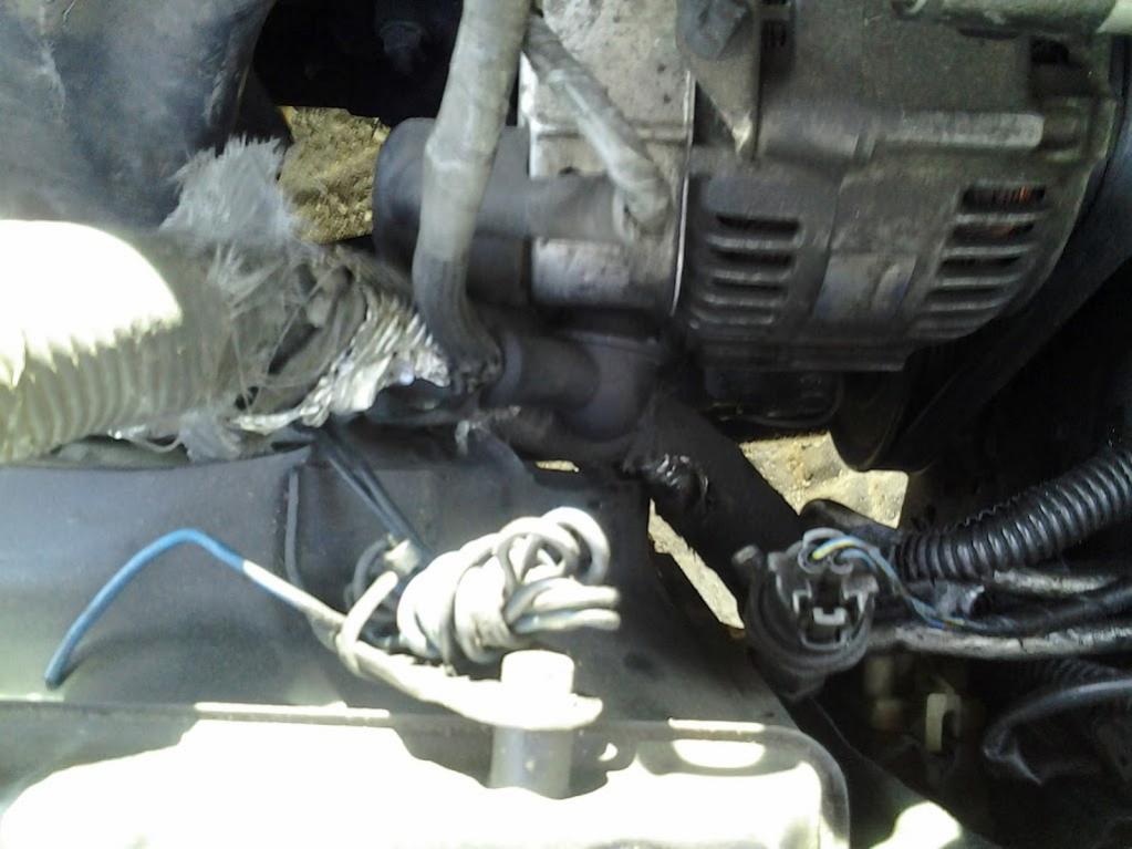

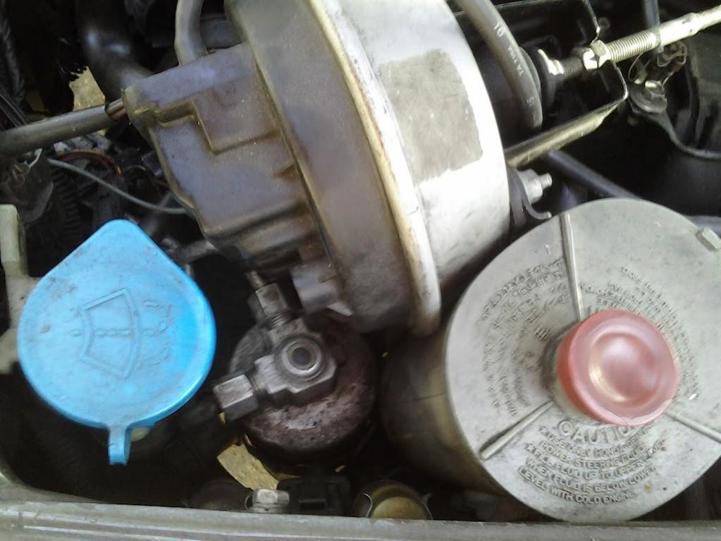

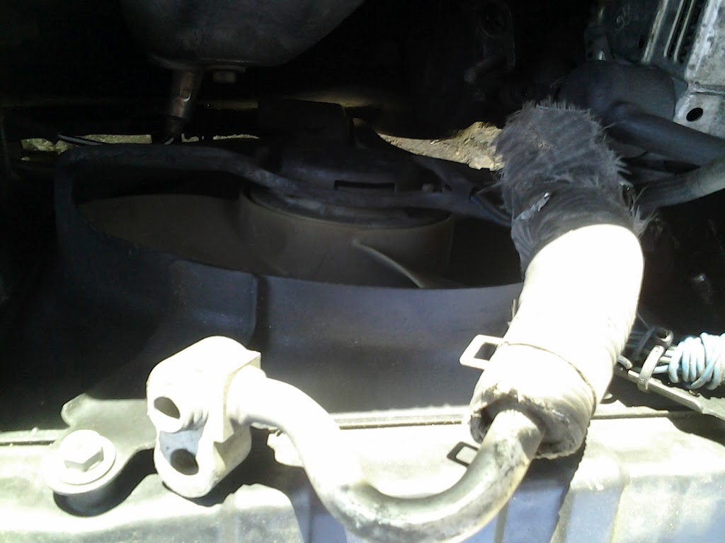

Old Jun 18, 2012 | 11:15 AM
Brandon Saunders's Avatar
Joined: Jun 2012
Posts: 26
From: Hesperia, CA 92345
here are some pics of the engine and you can see the ac is not hooked up. im just trying to get the radiator running. ty.
