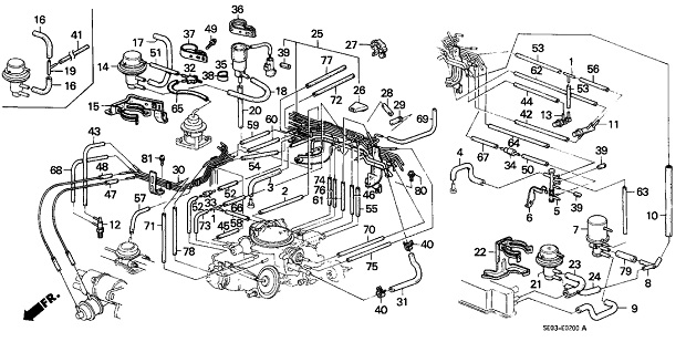

Doesn't the carburetor have a rudimentary idle-control system?
Parts drawing shows a "frequency solenoid valve" part #35 & "air control" valve #14. Together they are the ancestors of the IACV that we know today.
If you're chasing an idle problem, I guess you could clean them. I don't know anything about any adjustment or setup that might be needed. But don't forget to look for vacuum leaks anywhere in that rats nest of tubing.
