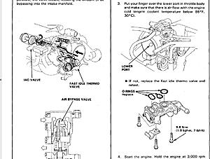

Assuming this is a 4 cyl.
Double check the coolant level, these don't like any air I the system.
There is also the FITV, again it uses the engine coolant to regulate the idle so being sure there isn't any air in the system is a good place to start.
Fast Idle Thermo Valve.
It is bolted to the bottom of the throttle body and has 1 or 2 coolant lines going to it. There is a metal cover you can remove. You can clean the valve, then snug the plastic threaded cap until it is snug.
See this video:
See this video:

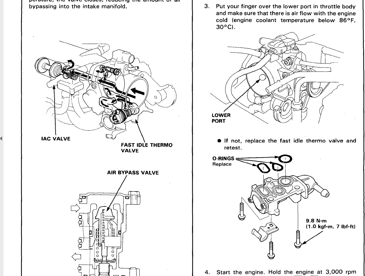

On the 5th gen's it is on the "bottom" of the Throttle Body with two small coolant hoses going to it. If you pull the intake dust from the TB you can see it better.....if you do pull that, you can look into the TB and there are two "holes", the lower is where the air goes through the FITV. You could start the car and let it start to act up and put your finger over the hole and see if it changes........PS, the upper goes to the IAC so you can play with that one if you want
EDIT: Slow typing, I see PA just replied
Removed and cleaned the fitv and iac. Also removed and cleaned the map sensor. A little better but still there-only when hot. No check engine light but pulled codes anyway and got 12 (I think) but the code checked to be egr. Will clean that this weekend. However pulled plug wires and the plastic spacer that goes in the head had large long cracks in 2 of them. Will replace them tonite and see what happens. Will also replace the fuel filter. Used stethoscope on each injector to see if any of them sounded different but all sound the same.
