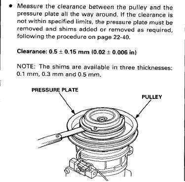

going to assume this is a nippondenso compressor
Attached Thumbnails 1996 accord lx 4 cyl. A/C problem need help troubleshooting-5th-gen-ac-clutch-gap.jpg

It appears to be a bad compressor....
The bearing already started making noise and the covering on the electromagnet is already melting.....
