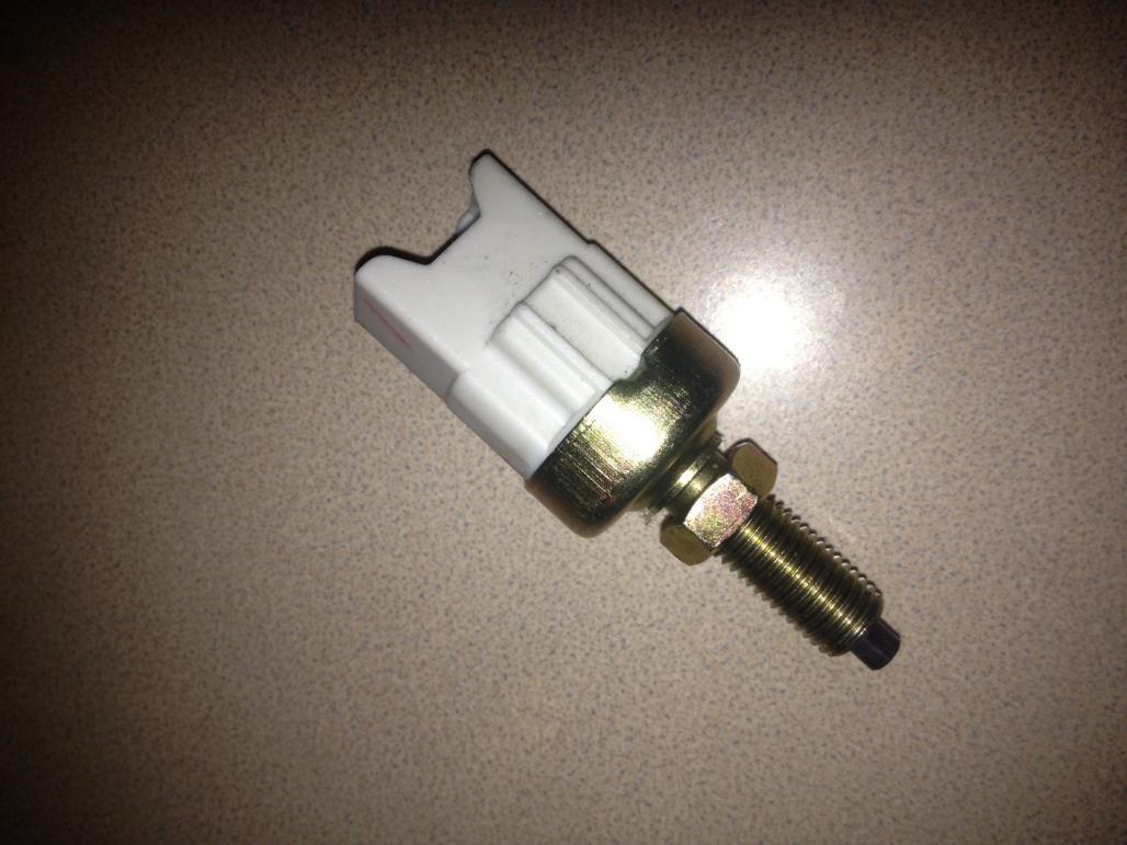

Yesterday, my daughter's 1998 Honda Accord (LX) had an issue with the vehicle stuck in park. Tried to release the gear shift but it would not move.
The horn worked. The brake lights would work only when the vehicle was not running. Once the vehicle was running, the brake lights would not work. I had to tap on the brakes 5-10 times until the gear shift would unlock.
I went to Autozone and picked up a Brake Switch for $27.00 and it took me 10 minutes to replace it. I disconnected the ground wire from the battery before I started. I located the brake switch (just above the brake pedal), loosen the nut and unscrewed the old brake switch and reinstalled. Connected the ground wire to the battery and now everything works again.
Easy fix.
