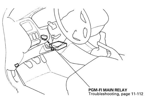

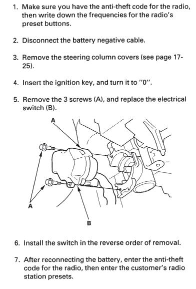

Old Jul 14, 2015 | 07:11 AM
Again, trying to figure out an issue when everything is working is pretty hard....trust me I spent ~2 years trying to figure out an issue on one of mine.
Just my opinion but I'm with either the ing switch or the main relay....don't replace anything on a guess.
For the ign switch, you would only test/replace the electrical part of the switch. The key has a chip in it that "talks" to the PCM. Sounds like when you replaced it the one time you replaced the entire key switch....hence why the car would not start.
The main relay is "way up" in the dash to the left of the steering wheel. There are tests you can do to the relay as well.
