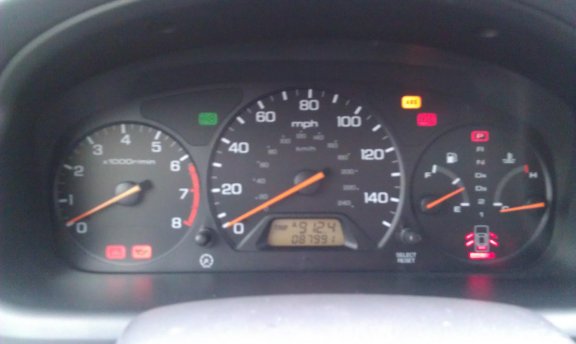

Ok I have a good one... My daughters 98 Accord EX 4cyl AT has a ghost. The problem has been happening intermittently for last 2 months.
What's happening is weird. When the car is parked with the factory alarm set (no other alarm in car) the alarm will trip. The alarm remote will not disarm or unlock the doors, I have to use the key to manually unlock to get in. The horn will stop in approximately 2 minutes. Once inside the car the instrument cluster is all lit up as if the key was in the ignition in the ON position. Put the key in and turn on and off has no effect. Alarm remote still has no effect. Lights are still lit. Car will not start either, engine just turns over. Then out of the blue lights go out and everything is back to normal. Car starts, alarm remote works. It has even killed the battery. I think it stayed "ON" till the battery died.

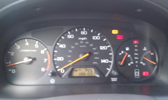

It gets worse. My daughter drove it to school and when she parked and turned the key off and remove the key the car was still running. She put the key back in and turned to the On position and the off, car still running. She turned the key to the ACC position and after a few minutes the car shut off. This has happened a couple of time now. It even happened to me last night. After bowling I got to the car and the dash lights were on. Remote would not work, car will not start. I disconnected the battery and reconnected, no effect dash lights still lit. However, I was able to start the car, but I turned the key off and removed it, car still running. Turned it on/off a few times, still running. So I turned it to the On position and drove home. Once home it shut off as normal.

I have also posted two pictures of the dash. One is when it trips the alarm showing what is lit. The other is when the key is out of the ignition and car still running.

Thank you PAhonda and Redbull-1 for your quick replies. The thing is it does not explain the dash lights coming on as if the ignition is in the ON position. I know the hood switch if faulty would trip the alarm but would not cause the dash lights to be on. (When I say dash lights I'm not talking about illumination lights. See pics above) To me something is powering the ignition up causing the alarm to think its being tampered with and going into full alarm. I really think the problem could be the one of the multiplex units or maybe the PCM? Is there any white papers on what they control? Wiring diagrams for the 98 accord?
