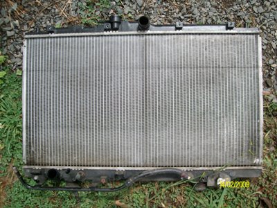

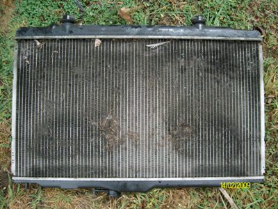

I am the original poster who had the overheating engine and the fans coming on and staying on after engine shutdown. Like you, I relpaced the thermostat and looked at the radiator fins but didn't see any problems. But the problem was in fact with radiator fins bit I simply didn't look close enough.
How did you actually check the radiator fins on your car? You cannot see if the radiator fins are partially blocked by looking down between the a/c condensor and the radiator (its only about 0.5 inch gap and doesn't allow you to look through fins, only across them. Looking at the back of the radiator through the cooling fans is a waste of time as well. The back of my radiator was very clean but the front was a mess. (see the attached photos).
You need to release the upper radiator guides allowing the radiator, with the fans to be pushed rearward slightly while sitting in lower supports. This should allow you to take an adequate look at the front of the radiator to check to see if the radiator has any discoloured patches on it. If so it will indicate an external blocakge. Its only a 10 minute job.
Regards
Terry
Attached Thumbnails 1998 Accord overheats with aircon on-front-radiator.jpg   1998 Accord overheats with aircon on-rear-radiator.jpg

I didn't need to replace the radiator. I just removed it from the car and took it to a radiator specialist who used a combination of washing and compressed air to remove the debris from the fins. If you have access to compressed air you can do this yourself but you must be very careful with the fins. They are very thin aluminium and squash very easily. In my case I placed the radiator in a tub of detergent water (it was actually the bath and boy did I get some grief), and let it soak for a couple of days. I then tried compressed air to blow out the debris (being careful not to blow too close to the fins or else they will be damaged). However, my compressor was pretty useless and that's why I eventually took it to the rad specialist to finish the job properly.
This fixed the problem. Once the engine warms up, the temparature gauge remains rock steady no matter what the drving conditions, engine load or outside air temp. As you can see from the photos, a good 60 or 70 percent of the radiator was blocked, so it was amazing the engine was being cooled at all. So there is obviously an excess of cooling availability in the radiator design which allows for effective cooling when the weather gets hotter, you are towing a heavy trailer and the air con is on! But at some point as the fins get progressively more blocked with insects, dust and debris, the cooling system will become overloaded. In that case, overheating when the aircon is on would be a quite possible outcome, particularly if this is in conjunction with warmer weather or towing a trailer.
Finally, if you have replaced the thermostat, checked that your engine coolant is in good order (no rust or heavy particle contamination) then an internal blockage (or water pump impellor corrosion) is less likely to be the cause. Only after you are completely satisfied that radiator fins are entirely clear, should you then start looking at electrical or electronic problems.
