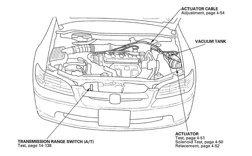

Any recent work done to the car? Can you check the vac line to the tank and the tank itselft for any leaks.

Old Jan 28, 2014 | 06:42 PM
The tank is by the actuator....left/drivers side fender.
Attached Thumbnails 1998 cruise rollercoasters up and down 6 mph-6th-gen-4-cyl-cruise-comp-loc.jpg
