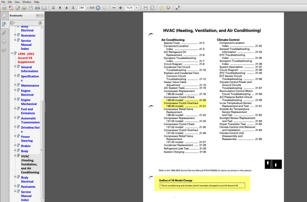

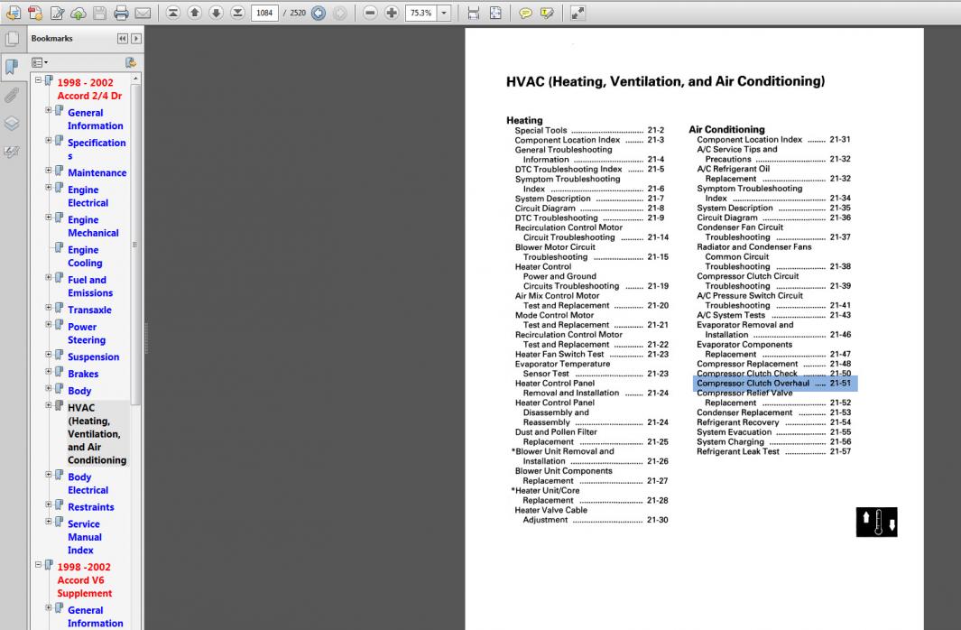

Old May 7, 2014 | 10:26 AM
Posts: 7,101
Originally Posted by Roader
HondaSid, the only manual I have was downloaded from the link in post #2 on page Hose above lower radiator? (01 LX), created 3/8/13. The manual's title is Service Manual 1998 - 2002 Accord 2/4 Dr. It doesn't cover the V6 engine Accord, just the F-series. Page 21-21 is titled Compressor Clutch Overhaul ('98-00 model), snapshot attached. The manual also has page 21-26 entitled Compressor Clutch Overhaul ('01-02 model).
It's the only online 6th Gen FSM I know of.
Show the PDF's bookmarks and it will show the breakout of both the 4 cylinder service manual and the V6 supplement.

Old May 7, 2014 | 11:00 AM
  #17
Roader's Avatar
Joined: Jul 2011
Posts: 1,008
From: Denver
Huh. So that PDF has both documents in it. Great info, Redbull!
