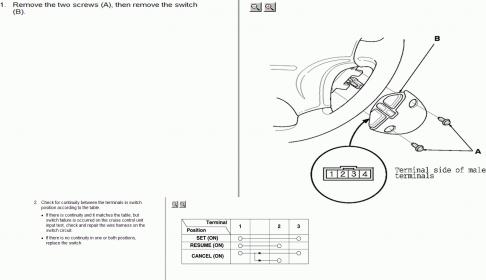

Here is the switch test; But keep in mind the switch signals have to make it thru the spool reel
And a Link to a better pic;
http://hondadude.webs.com/99AccCruiseSwtchTest.gif
