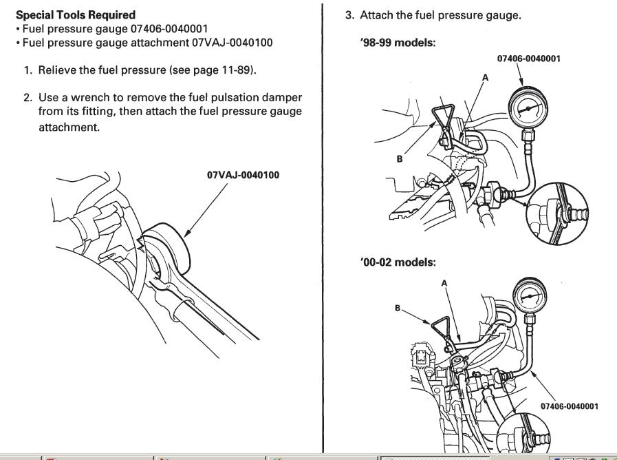

Talk about piggy back on a thread....I also have a 2000 v6 accord and have been experiencing this problem. It's happened a couple times in the past, but today it has been especially bad. Lots of good info on this thread, I have the EGR code, have had it as long as I've had the car...after reading, I know many more things to investigate. Quick question, where is the port where I can check my fuel pressure and what pressure is this car supposed to hold?
Old Mar 25, 2012 | 07:15 AM
  #22
There isn't a "service fitting", you have to tee into the rail where the line attaches.
For the 98-00 v6. At idle with the pressure regulator vac hose connected 32-40 psi, disconnected 41-48 psi.
Attached Thumbnails 2000 EX: Intermittent Stall on start-6th-gen-v6-fuel-pressure-testing.jpg
So that explains why I couldn't find it....thank you very much for the info and diagrams.
