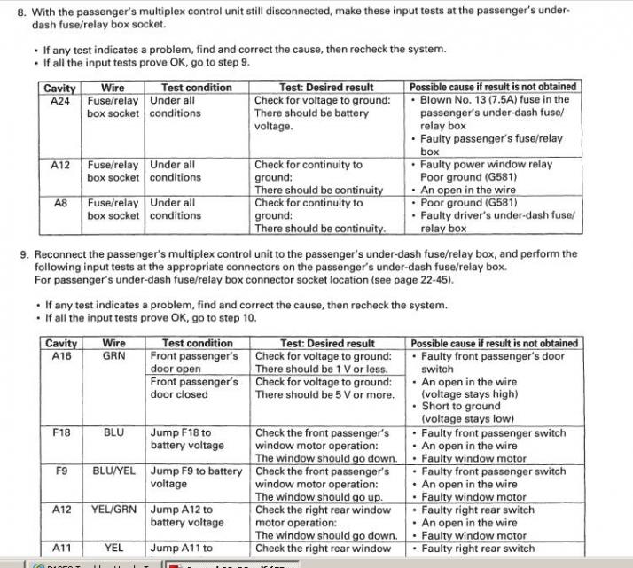

So if you jump F18 from the pass side multiplex to 12v, nothing happens? If true the manual says you have a bad pass side switch, bad wire to the motor or a bad motor.

Are you willing to do some of your own tests? I thought I posted these last night...I am old and slow so who knows what I did.
Attached Thumbnails 2000 Honda Accord Coupe Ex V-6 Passenger Window Problem-6th-gen-pass-multi-window-tests-pt1.jpg   2000 Honda Accord Coupe Ex V-6 Passenger Window Problem-6th-gen-pass-multiplex-connectors.jpg
