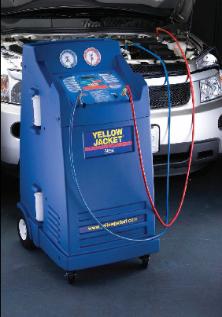

The mechanic that worked on my air conditioning this morning had a machine that looked something like this:
Picture from: Automotive Service Equipment
I got one question: 1). The engine was not running when the mechanic this morning did the evacuation and leak/suction test. If the compressor were leaking, like the first mechanic said, would it show on the suction test when the engine was off?
