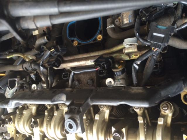

Now for civic, prolly going to do the same. Can anyone please advise how to pull dam injectors out? We have removed two bolts and they are proving to be a PITA and not ready to move?

Civic - so I'm not sure on how they come out, looks like there is still "piping" over them.
When I had to pull the head on a 3rd gen carb - I found it easier to pull the head with the intake attached Not sure if this thought applies to this car or not but I can tell you on that 3rd gen it made a few things a lot eaiser - I was sure the intake was back on and got all of the bolts/nuts to the proper setting.

Thanks so much PM, guess we can try pulling the head with intake attached, but still need to pull the injectors out of head, correct?

Usually the injectors are in the intake - at least on the cars I have worked on.
Even if they were in the head - pull the head with them still there - just remove the wires.
