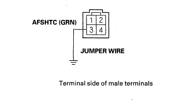

I pulled the wires out from the connector that goes to the O2 sensor. Can anyone help me with finding the wiring diagram from this area?

I attached a picture of the connector. Your picture is upside-down compared to my attached picture, so make sure you are using the correct orientation on the connector relative to the release tab.
1 - Red/Yellow
2 - Red
3 - Green
4 - White/Black

Hope this helps
Attached Thumbnails 2005 Accord EX 2.4L I pulled the wires from the PCM sid of the O2 sensor connector.-photo18.jpg

Thank you both for a quick response. Definitely solved my problem. So in my research I found this and wanted to add to the thread with a color diagram. Once again Thank you both!
