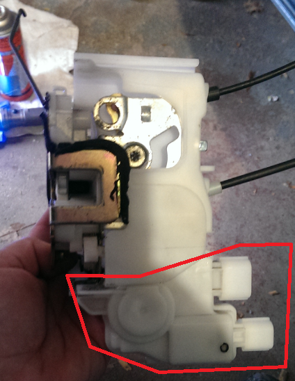

I ended up removing the actuator/lock assembly, but I only replaced the actuator (See picture). Unfortunately, this did not fix the issue.
I ran out of time yesterday so I put everything back together and left the actuator disconnected. Everything, except the driver door power locks, work fine.
So my driver door won't unlock with everything plugged in, but works fine mechanically when there is no power to the actuator.
My next step is to replace the switch, not the lock assembly. I figure mechanically, everything is fine, so focus on the switch.
Any other suggestions on what it could be? Does my car have a control module for the power locks?

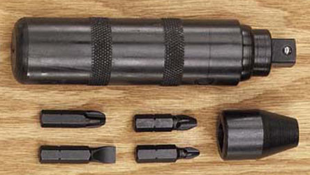

Be patient with the 3 screws on the outside that hold in the actuator. They can easily strip. I used Aero Kroil and a hand impact with light to medium force. And a P3 Phillips bit.

Are you saying the actuator did not fix the problem, so the door latch assy must be replaced?
Yes, those screws are difficult to remove. An impact screwdriver as you used is almost essential.

Correct, the actuator did not fix the problem.
I contemplated changing the door latch assy but it mechanically works when the battery is disconnected.
I think changing the switch on the door panel makes more sense. What do you think?
Old Nov 12, 2015 | 09:32 PM
The door not opening from inside or outside (despite door lock being manually or electrically released) is usually a mechanical fault in the door latch. It may be intermittent.
If you review the video in the attached thread, you'll see what a job it is to release the latch. You might consider replacing the latch to prevent necessity of such an intervention.
