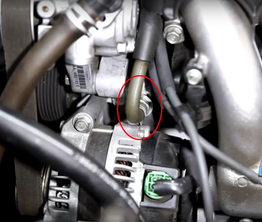

Yup, pull the hose off the PCV valve and check for oil in it.
Here's the location.

AS s for leaks, NONE. I checked the intake air tubing and it is dry inside. There is a hose , top of valve cover, driver side going to a valve of some sort, right on the intake air tube. A little oil in this hose right at the valve cover. No oil where this all enters the intake air tube. PS: Air filter is clean.
Thanks Doc for the pic of PCV valve

That hose to the intake is the other half of the PCV system. It's supposed to draw air from the airfilter, to make up for what is sucked out of the crankcase through the PCV valve. Having a little oil in there is kinda normal. A lot of oil in that hose is a sign of the PCV valve clogged up.
