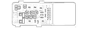

Old Jun 22, 2020 | 10:00 PM
  #33
Seanjordan20's Avatar
Joined: Jun 2017
Posts: 1,225
If you haven't checked yet:
Interior box
29 - clutch 7.5a
Engine bay
12- clutch relay 30a
R4- clutch relay
Those are the only fuses/relays on the hybrid that can affect the compressor operation
