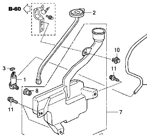

Latest problem is that my windshield washer suddenly quit working. Not been used a lot over the years. Bottle is full, wipers work, but washers do not. I don't hear a noise when I activate it, so I suspect that the pump is not working.
A couple of questions
Firstly, where is the pump loacated and how do I gain access to it ?
Secondly, looking online there seem to be several brands of pumps available for about $20 - is any brand better than another ?
Thanks in advance for input
Old Feb 26, 2012 | 06:33 AM
It is on the tank.

I found a few references that said to gain access via the wheel well and inner fender. Sounds like a labor intensive and dirty job. Seems to me that just removing the tank would be easier.
I have ordered a Trico replacement ($20). Honda dealers wanted at least $60 for OEM part. Given that the OEM part did not last long I figure I don't have much to lose.
Will probably trade this car on a Toyota later this year - despite the hype I have found the Honda to be problematic - though it does handle well and the engine runs smooth. Just too many electrical problems.
Old Feb 26, 2012 | 11:51 AM
Really not that bad to get in there, dirty part will only be getting the tire off....after that there are some small screws for the inner wheel well......

Old Feb 26, 2012 | 04:10 PM
Posts: 7,101
1. For the washer, the first to check should have been the fuse, it should be the no. 20 (7.5A) fuse in the driver's under-dash fuse box. The motor rarely goes bad, as it is not used often.
If the fuse is okay, then move on to checking for blockage in the tube or the motor. The motor can be checked after getting access to it. You would remove the 2-P connector and then can apply direct power to the motor side; for your car, either the pin 1 is to power (+) and 2 is ground (-) or the opposite. If applying power, only apply power briefly; otherwise, you will burn out the motor even if it was good.

I just checked every 7.5 A fuse in there, all OK. Must be a pump problem. I checked fluid hoses and no kinks.
