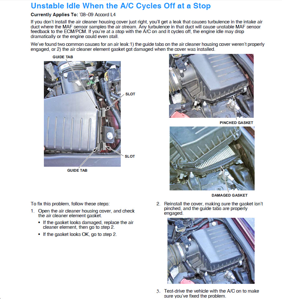

Although it's been about 10,000 miles since the air filter was changed, check if the air cleaner housing cover was re-installed correctly. There are guide tabs that suppose to go under the slots. If not, it can leave an air gap in the air cleaner housing.
Attached Thumbnails 2009 Accord LX very loud engine-8th-gen-accord-4-cylinder-air-cleaner.jpg
