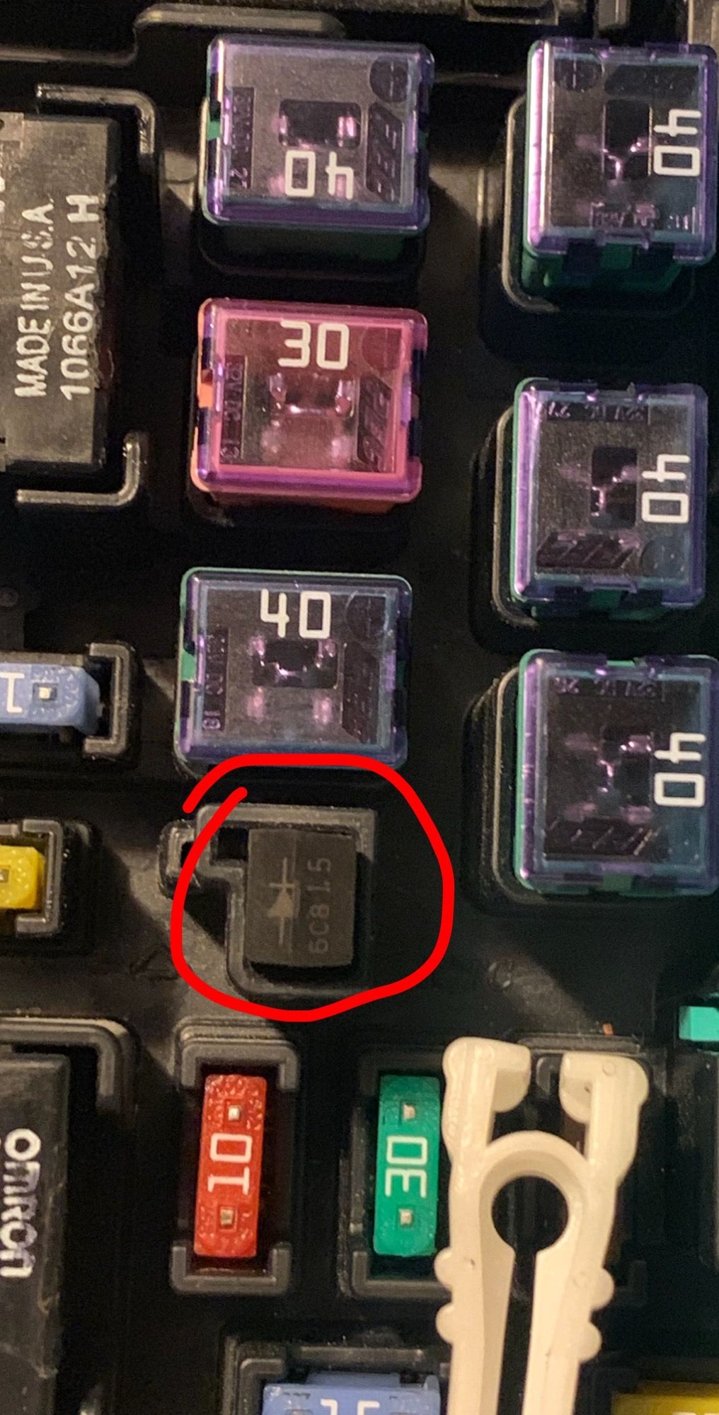

Also does anyone know what this is
Old Jul 24, 2019 | 08:23 AM
The symbol is a diode, so it'll be directional. Does the plug/socket allow it to be reversed? Hopefully the plug is directional so it can only be plugged in one way.
