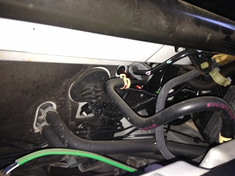

I got my third Accord, a 2009 Coupe LX-S, about a year ago in June and it's great! I was looking yesterday for a preexisting hole in the firewall to run a power cable to the trunk for a sub/amp and couldn't find one that looked like an easy target for installation. Has anybody done an amp install through factory drilled holes on this generation and can tell me where I should run the cable? If not, any suggestions for where to drill a hole myself? It's a 500W RMS @ 2 Ohm amp, so I need a hole for 8 gauge wire.

Found a hole in the firewall so posting pictures here for future reference (Higher res in links). Look for the shiny red wire. Grommet is near center of car, closer to driver side. I did this on a 2009 Accord Coupe LX-S.
There was nothing going through the grommet, but I assume higher end models will have something going through it already. Poke the grommet from the cabin side and it will pop out. Drilled a hole through the grommet and 8 gauge wire will fit through it. It may even be big enough for 6 gauge wire. Put the grommet back where it went and it's done!
Engine
Cabin
