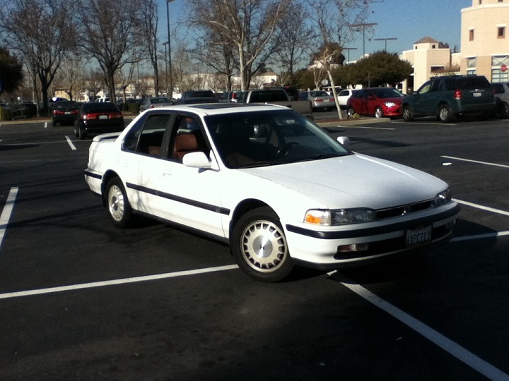

Nice Cb7, have you tried the relay, or cruise control switch and set/accel switch.
