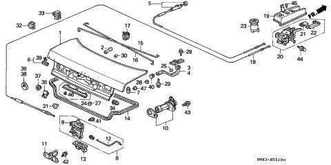

Hey all! My trunk has started leaking and I'm not sure where it's coming from. I asked my friend about it since he has a 90' and he took a few pictures for me. I discovered he had a trunk lid seal on his trunk lid and I don't have one on mine. I have one on the trunk itself but not on the lid. Could this be why it's leaking? I notice that both sides of my trunk are wet too. Any help is greatly appreciated!

Yeah, looks like there's supposed to be a weatherstrip around the lid (#14 in picture).
I think the taillight gaskets are also a common place for water leaks, so check them.

I would definitely replace missing parts. Here is a parts blowup of the 91LX.
#14 is the trunk lid seal:
I can't tell if that part goes on the trunk lid, or the body of the car. The part is pricey at the dealership (~$100), so I would try to find one at a junkyard. I don't recall reading about that seal failing, so it may be worth a shot.
The tail lights were known to leak either at the seals or through cracks in the plastic. Take a close look at your tail lights.
