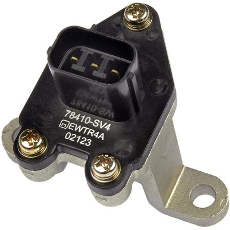

So I'm trying to change my VSS today, as it's gone bad. I get the thing bolted on and ready to go and when I go to connect the electrical connectors, much to my dismay the connectors wouldn't fit. After inspection I see that the connector that is attached to the VSS is a male end connector, and the port where the VSS connects to (not sure what it's called) is also a male. Every VSS I can find has a male end connector on it. The guy at the parts store had no answers. Does anyone here have any idea what could be going on here? Is it possible to find a VSS for this car that has a female connector? I'm really dumbfounded and have no idea what to do.

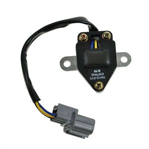

Got pic's of the old one?
Attached Thumbnails 91 accord VSS question-vss-part-1.jpg   91 accord VSS question-vss-part-2.jpg

Old Jun 14, 2015 | 07:03 AM
Which of the two pic's I posted does yours look like? The pic's are of two different "types"..........

Ahh, sorry I didn't catch that. The original sensor is the one on the bottom, the one that has the connector on top. The replacement I bought and the only one I've been able to find is the one on top, the one that doesn't have the connector.
Old Jun 14, 2015 | 10:18 AM
Try looking at one from a 94-97 Accord vs the 90-93 Accord.
EDIT: The two pic's I posted are from those year models. Someone might have swapped the trans out on the car before.
