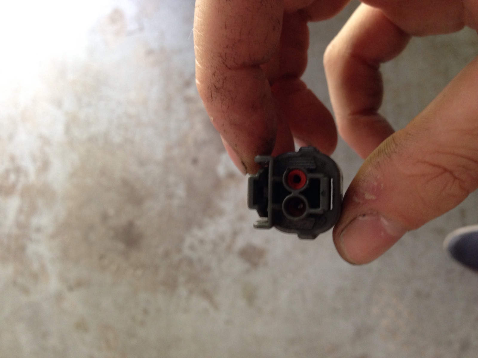

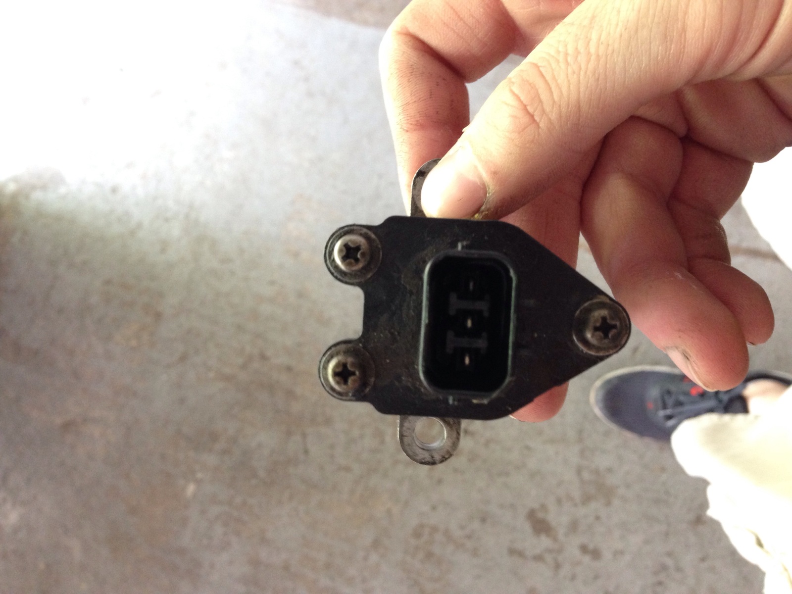

So this is the original sensor that I was replacing:

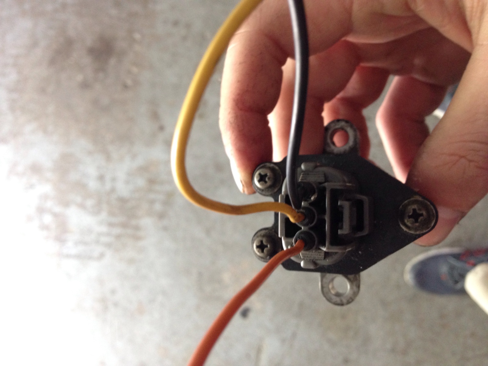

This is the sensor with the wires and connector on it:

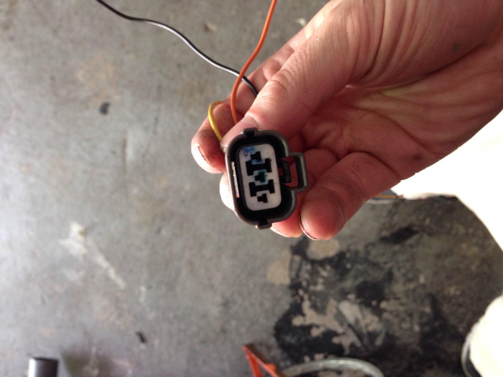

This is a shot of just the connector that goes on the sensor:
This is the connector that ran from the sensor:

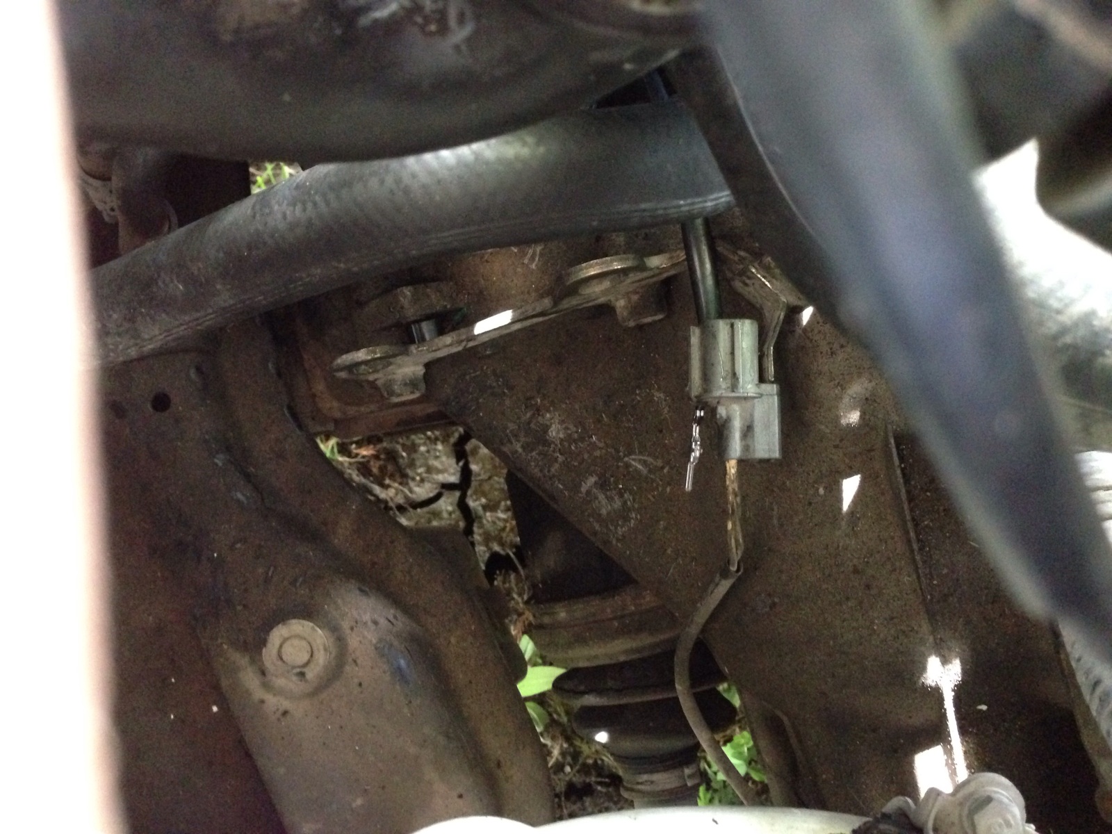

And this is where the connector that runs from the sensor, the previous image, connects to.

The solution to this seems very simple to me, sell the sensor with the wiring/pig tail! I don't understand why you can only buy the sensor with no wiring. If there was a simple pig tail that came with it it would be an easy fix.
Right now the only solution I'm coming up with is trying to splice the wires off the sensor with the wires on the other connector. But then the sensor has three wires, the place it connects to has two. Is that a problem?
Edit: alright so I now have a better understanding of what happened and I really hate myself. If I would have known this car had a 94 sensor then I could have ordered that, replaced the sensor and snapped the wires right back on. But instead I got the 91 sensor, which came with wires. So being stupid I assumed I needed to get the wires from the old one off, so I tried, they wouldn't come easy so I had to pull so hard that I ripped them out. I never should have touched those wires in the first place. Am I right?

The VSS will have a ground, signal, and 12V wires, so rewiring should not be an issue. EDIT: I think you need to find the proper sensor. Verifying the wiring isn't too difficult once you reinstall it.
I'm confused a bit. I'm guessing the orange and yellow wire connected to the two pin harness. Where did the black wire connect?

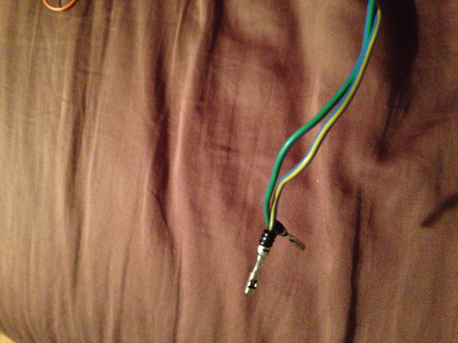

I have no idea about the wiring. There's three wires coming from the sensor and two wires going into the opposite connector on the pig tail. There was a lot of taping and seemingly some splicing done.
Edit: I left this photo out. So these were the wires going into the 2 holed connecter.
So it appears to me that the wires from the sensor were not connected to the two pin harness/connecter at all. They were somehow for some reason spliced with the wires I posted above. Hence all the tape work? I don't know.
