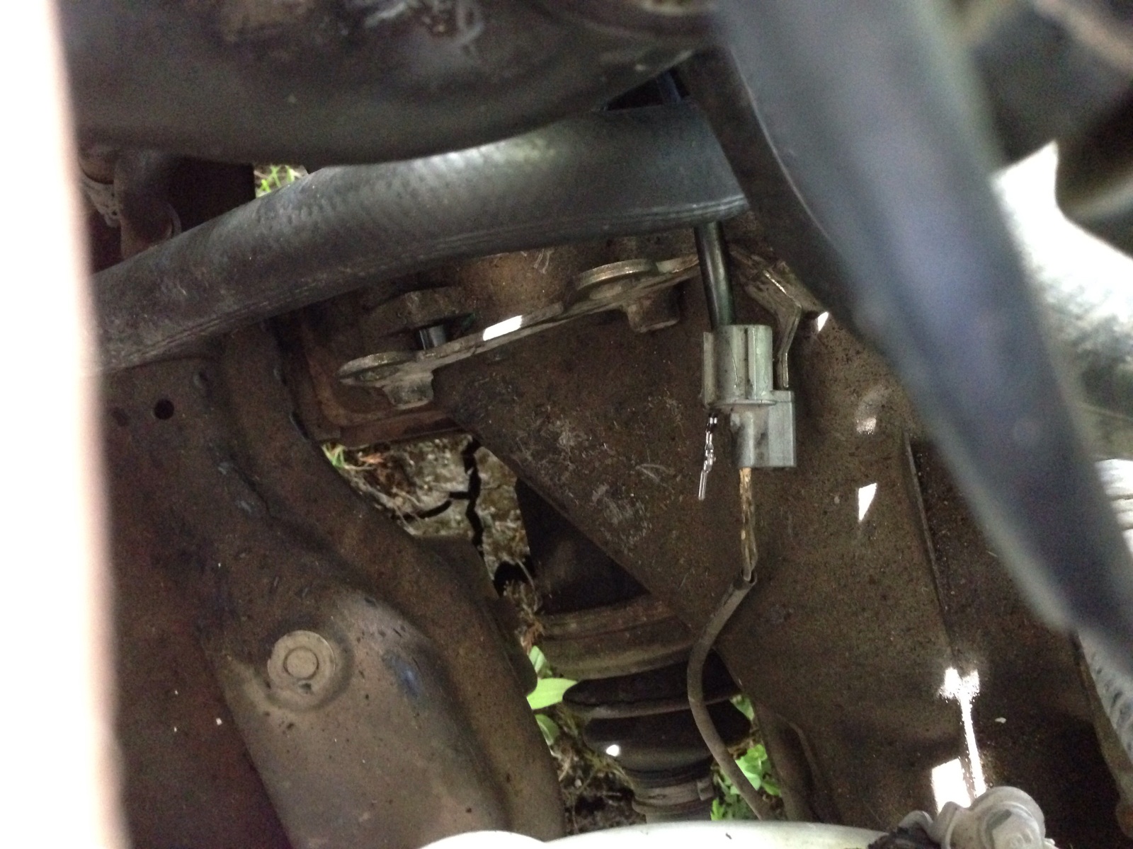

So I ripped out the wires to the countershaft sensor, that explains it all. And the countershaft sensor plugs into the connecter on the passenger side fender, the one I posted a pic of? So if that's the case, the countershaft sensor must have a female connector because that connector on the fender is a male.

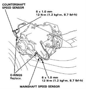

So if this is the correct diagram:
Then this is the wire from the mainshaft sensor:
So in that case, what plugs into the mainshaft sensor? Or the mainshaft sensor plugs into what?

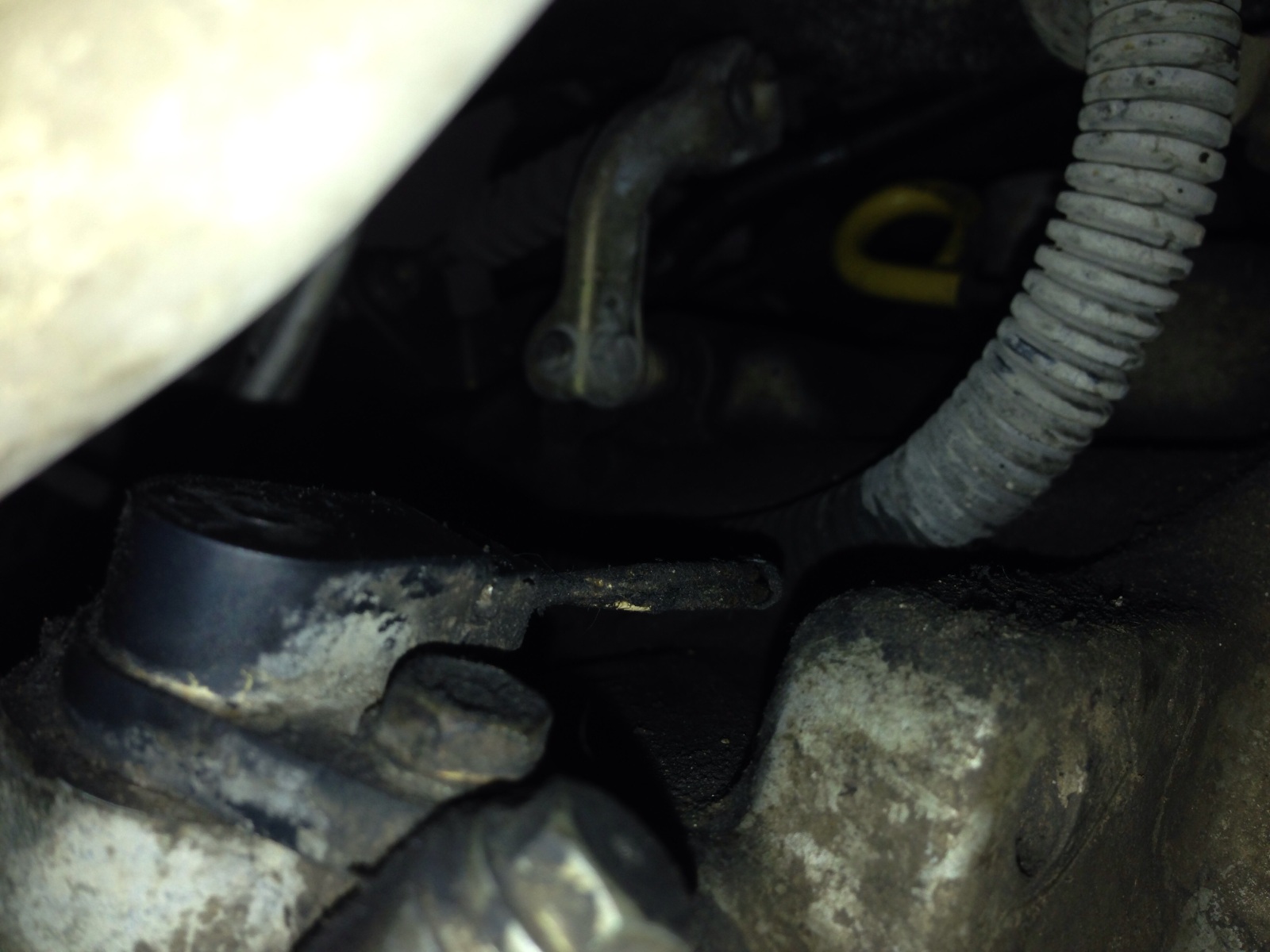

Think I found the countershaft sensor
It's down below the trans dipstick.
I didn't touch that thing. Didn't even come close to it, it's still plugged in and fine. So it can't be that. What are the chances that I have a faulty vss to blame for all of these problems? But that still doesn't explain what connects to the mainshaft sensor. It has the be the vss.

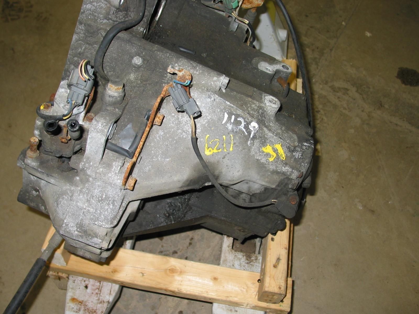

Here is a picture I found of the speed sensors. The VSS is on the left, and the countershaft sensor is on the right (I think). I never owned an accord with an automatic transmission.

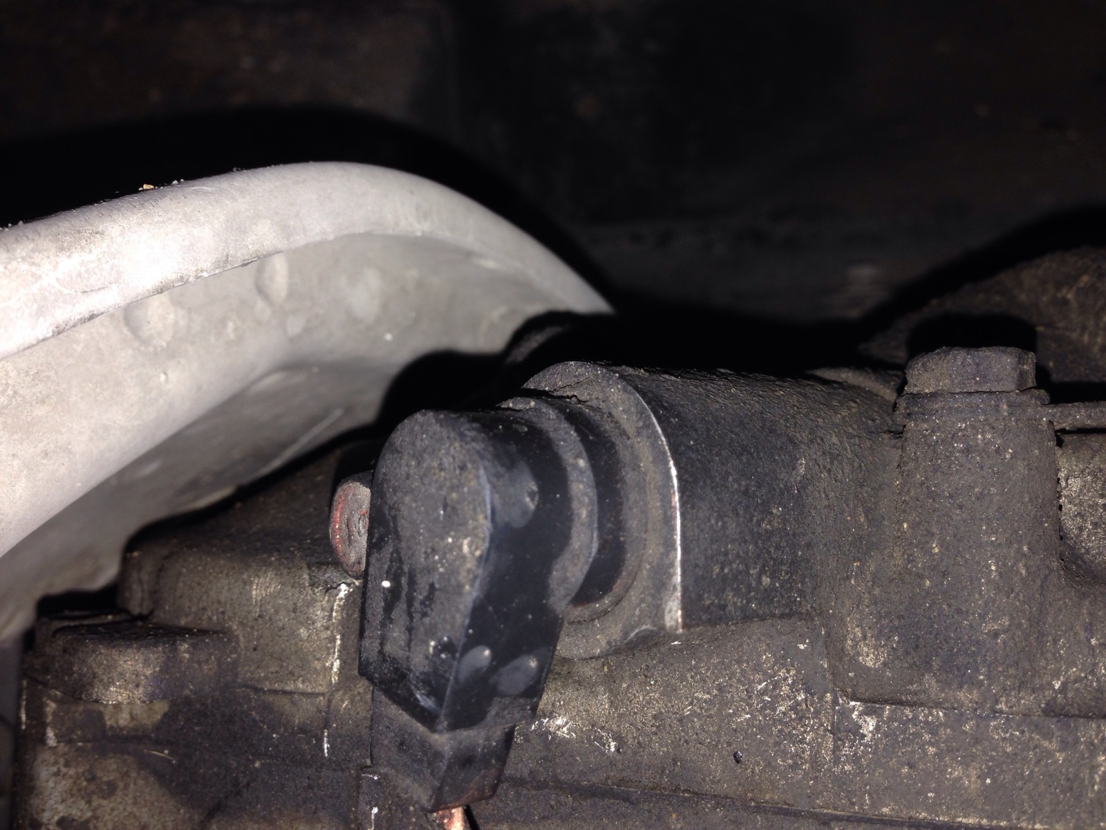

I believe I've found both sensors unless there's more I don't know about. The pevious picture I posted, right below the trans dip stick, you have to take the splash guard off to get to it.
You can see the yellow dipstick up there.
And the other sensor is right below that, right above the passenger tire. Both on passenger side. They both look like sensor heads, very similar looking with one bolt holding them on. You can see the fender of the car. The trans drain bolt is right below
I know it would help to take pictures further away. I'll do that tomorrow. im just trying to describe what you're seeing there.
Attached Thumbnails 91 accord VSS question-27yn7g6.jpg   91 accord VSS question-wu2hc2.jpg
