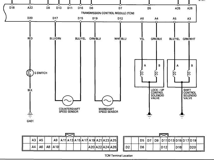

Ok this is just me....sorry, I had my own thing to go do yesterday afternoon.
Someone has been playing with wires on this thing....since you have had this car has the speedo ever worked, were you always getting a VSS code?
I ask because the two wires in the one pic - BLU/GRN and BLU/YEL would match up to going to the "Counter Shaft Speed Sensor"...so I'm now wondering what is pluuged into that? It is on the "end cover" of the trans kind of towrds the firewall side of the car.

The speedometer has always worked and I've never gotten the Vss code until last week. Been driving this thing for a year now.
I really have no idea, all I know is that those two wires were apparently spliced with the wires from the vss. And those two wires were plugged into the connector that I posted.
I know absolutely nothing about a countershaft sensor or anything. I thought there was only the vss. so when i ripped these wires out could i have ripped some other wires out?

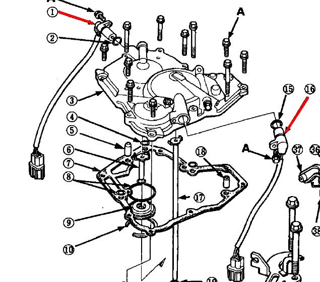

I'm just going off the wire colors in the pic - they match up to the wire colors for the counterchaft sensor.
The counter shaft and main shaft sensors are on the "end cover" of the trans - might have to pull the pass inner fender (platic splash shield) to get a good view of them. I'm just wondering if somehow they got swapped around.

Alright so I got my tcu (flashing s) code. It flashes 9 times. So that would be the countershaft speed sensor? Also, when I search for this part all I can find is input and output shaft speed sensor. Which one of these would be the countershaft sensor?
