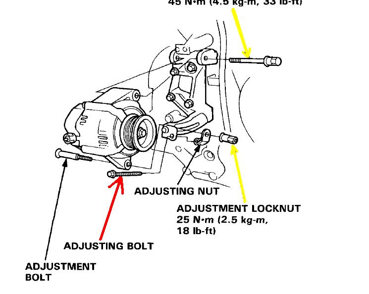

- Installed a new alternator and found out the "adjustment bolt" was missing which causes a squeaky annoying noise while driving. Where can I get a bolt from?

Not sure which bolt is broke? Got a pic.EDIT: Or see if this helps in "which bolt"...sorru forgot I even had this.

As for bolt it's the one the red arrow is pointing at.
Old Apr 4, 2013 | 08:08 PM
You can get the bolt from the dealer or find and "aftermarket" version. Just know that bolt "threads" into the lower alt bolt, so you want to be sure it didn't break off in there.
