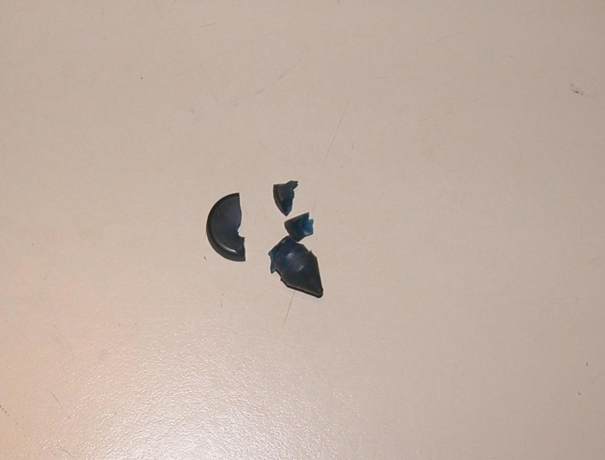

Old Sep 14, 2013 | 11:14 AM
Find any strange plastic pieces on the drivers floor?
My car is having this same issue.. but is an auto (unfortunately). And I have found these peices on the floor, what is that supposed to mean?
That is the pedal stopper pad.
For your automatic, your car only has the stopper pad for the brake pedal assembly. When you press on the brake pedal, the brake light switch plunger extends and the contacts on the brake switch closes (which turns on the rear brake lights). When the brake pedal is not pressed, the plunger is suppose to be depressed when it contacts the stopper pad, which leaves the brake switch open (and brake lights stay off). Without the brake pedal stopper pad there and if you do not press on the brake pedal, the brake lights will stay on.
This link shows some pictures and other info.:
Brake lights stay on...how I fixed them - Honda-Tech
For cars with the manual transmission, there are two other pedal stopper pads for the clutch pedal assembly. For a manual transmission, if the pad for the clutch interlock switch is missing, the car may not start, as the power would not be going all the way to the starter relay and starter. This link has some info. regarding how the pad cause this person’s car not to start.
