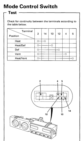

Re-soldering the joints on the mode switches and LEDs did the trick.
I followed the manual guide to check for continuity on the circuit board, and reinstalling was a breeze.
Thanks travrach!
