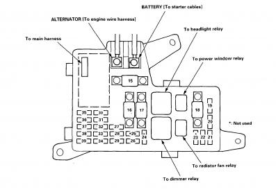

That was from my suggestion. When my radiator fan relay went out, I switched it with the power window relay. My windows wouldn't work, but my radiator fan worked.
See pic for window relay location. It is right above the radiator fan relay.
