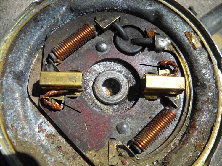

You may be able to fix the motors. Carbon from the brushes gunks up the bearing and stops the shaft from turning. Disassembling the motor, cleaning out the carbon, and lubing the bearing got another (so far) two year's life out of mine.
Old Apr 3, 2013 | 12:32 PM
My experience w/ these motors is simply to replace them. I tried to repair 1-2 and found that brush replacement is very difficult. There is no provision for temporary brush retraction to engage the armature during re-assembly. The one I managed to re-assemble only worked a short time before brushes tumbled again.

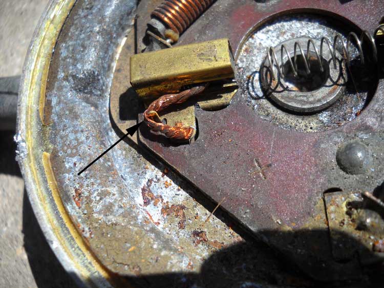

You can hook the brush leads over the brass tabs that are part of the brush holder (see pics), put the motor together, crack it open a bit and, using a very skinny screwdriver or the like, flip the leads off of the tabs. I imagine that's what the tabs are for.

Ha ha. When put so plainly, it makes a lot more sense than the crazy possibilites I think up throughout the day. I think you are both right Jim and Jeff; one probably failed a while ago and I only thought to check after the second one failed. I will still check my voltage at the battery while revving the car though, as was suggested. I guess my original thought was that the radiator fan control module may have somehow shown a current spike, but in reality, that module only activates the cooling fan relay which in turn provides battery voltage to the fan now that I think about it. (Gotta love those PDF shop manual wiring diagrams!)
Roader, I had never even thought about cleaning the motors. I might actually give that a shot first, at least try my hand at it, and if i fail i am no worse off (thanks for the pictures by the way, that procedure makes sense). If I can't get them turning again, I can still hit up the online stores and buy them new. Any suggestions on type of grease? All-purpose black grease or white lithium? Thank you all for the quick responses! We should have the fans back up in no time. Then it's on to the AC compressor cycling on and off pretty frequently...

Grease: Any of those or even a few drops of motor oil. The toughest part is getting the tabs bent out to separate the motor halves. There was plenty of brush left on my 250K fan but, as you say, the worst that can happen is having to pony up for a new motor. Note that the pics/procedure is for the flat condenser fan motor. I've never taken apart the radiator fan motor which is a conventional, cylindrical motor.
