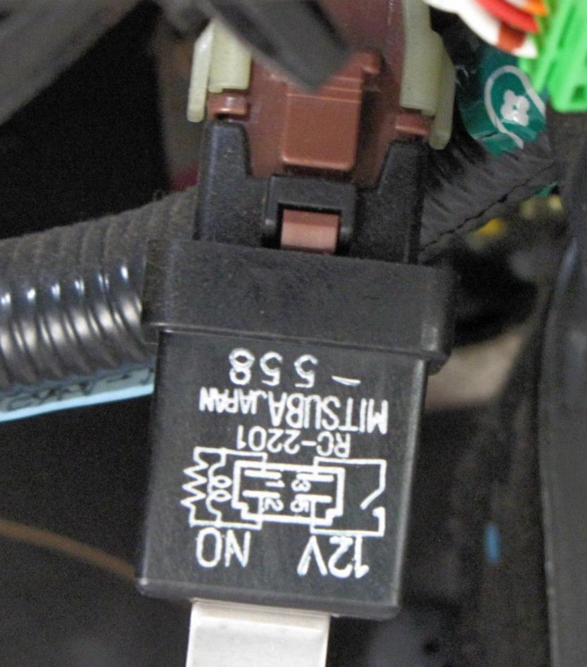

I am not sure what is the purpose of that relay which is dangling next to the security system control console. I am attached the picture of the relay as well.
Still not able to figure out what would be causing this car not to start.
Now the car wont start even once, just tries to start, but engine doesnt catch.

I do not think its happening because of the security system, because I read that it is just a siren/horn for this model, not an immobilizer. Or am I wrong?
I will stop playing with it, and start looking for the ignition switch. Worst part is I dont have anyone to help me crank the car right now. I will get someone tomorrow to crank the car to to check for the sparks.
And I will try to take the ignition switch out as well.
