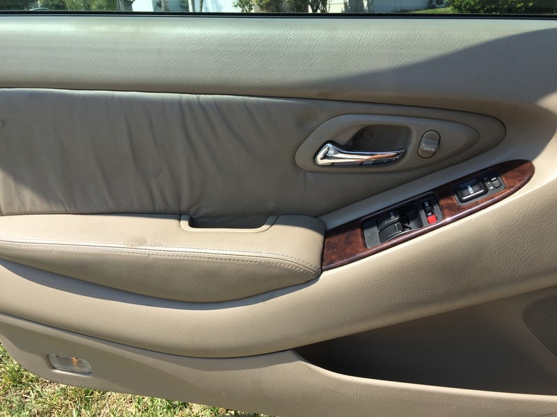

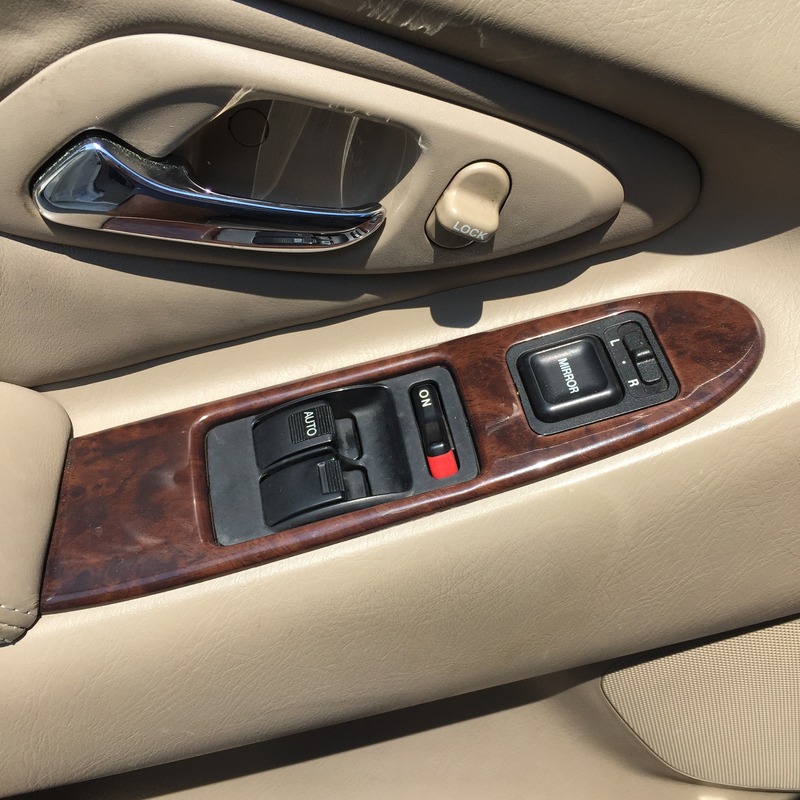

I found a use master switch already. However, I'm having issues trying to remove the switch on my car. The videos and instructions dont seem to help for my specific car. The arm rest actually covers part of the master switch surround, but the armrest appears to be rivetted to the door panel and not removable. If I were to try and pop out that switch with the armrest there, it surely will break.
Any thoughts...here are pics of my 1998 2 door coupe accord

The door switch is not actually covered by the armrest. The switch panel is held on with clips. Just gently pry it up a little at a time.
