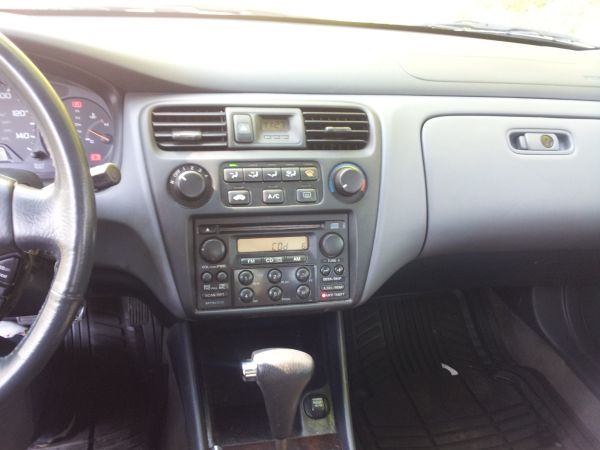

Does this have auto hvac or manual hvac?
This pic is of what I call manual HVAC controls
Attached Thumbnails 99 Accord cooling heating switch on off while driving-6th-manual-ac-controls.jpg

Most likely you need to replace the HVAC unit, unless you are good at finding and repairing bad solder joints on a circuit board. They can be had on ebay last I checked for $50 to $75.
