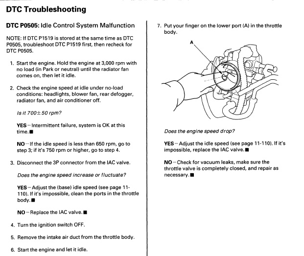

Examine PCV system from valve cover to throttle body for leaks, cracks, disconnected.
Examine brake booster line from throttle body to brake booster for leaks, cracks, disconnected.
Check EVAP system for vacuum leaks tracing from intake manifold.
Listen for hissing sound of vacuum leak.
Try disconnecting IACV electrical connector to see if idle stablizes. Idle may still be high, but this would confirm air leaking into system somewhere.
Other possibilities are intake manifold leak, valve cover leak.
Shop manual says for idle fluction to perform idle speed adjustment, inspect/adjust throttle cable, inspect/test throttle body. You need the shop manual to address these.
I disconnected IACV and idle stabilized at the high point (2100-2200rpm). I removed the intake duct, and plugged the hole as described in below image. Instead of the doing nothing, or idle reducing, the car just died.

Since engine died when IACV port was plugged, a stuck open IACV is suggested. When you close the port, engine was starved for air and died. Suggest removing IACV and carefully cleaning/inspecting to be sure the solenoid valve is functioning. It could have failed in open position.
You have been so helpful with this. So to confirm, the failed IACV would cause the high idle and the surging as it's basically creating a vacuum leak. Is that a crude understanding?
Odd that it would work before I took the head off and then not work after. Unless the oil in the water gunked up the water passages. Hmm....likely?

Your description indicates the IACV is either failed open or stuck open (gunk). The IACV can be removed and thoroughly cleaned and function checked (apply 12V/ground to connector). Valve will click open and close on removal of power (spring loaded). If valve stays open after cleaning, a replacement IACV will be necessary.
