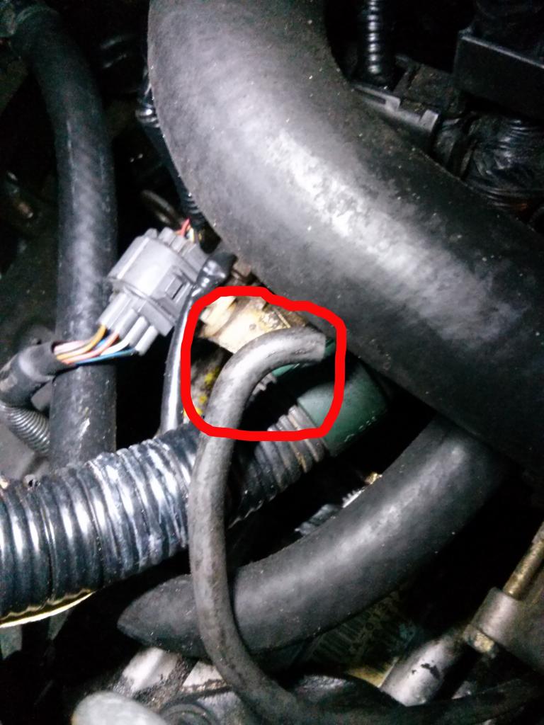

You've all been very helpful, I wanted to give an update. I did the valve adjustment and put the valve cover on. Spark plugs in. All but one hose is hooked back up because it was replaced. I need to add oil, flush cooling system and put timing covers on. But, one major hurdle I have to get over before properly installing crankshaft pulley. 181 ft lbs of torque?? No impacts (I don't have one anyway). I do have the tool but was just wondering if anyone had any methods to suggest.
And lastly I have a vacuum hose that has an end missing it's home. It comes out of the top of the transmission but I can't find where it goes. Pic below

A five foot piece of pipe over a breaker bar will give plenty of torque for the crankshaft pulley.
As I recall the trans has a vent hose that doesn't connect to anything; I thought it clipped into place somewhere.

Perfect, got it torqued down. Found the clip for the hose I believe. Makes sense as I don't remember taking a vacuum hose off there.
