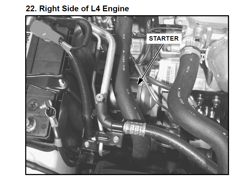

Verify you have 12V going to the small wire at the starter (blk/wht I think) when you turn the key to the start position. You'll probably need an assistant. You can also have them hold the key in the start position and tap on the starter near the small wire with the handle of screwdriver with light/medium force.
Old Oct 9, 2016 | 04:45 PM
This is a photo of the location of the starter for a 4 cylinder engine.

Thanks, tried tapping the starter but with no success. Nothing was blown in the fuse box either. A neighbor helped me get another starter, and is helping put it in. I'll let you know the results!
