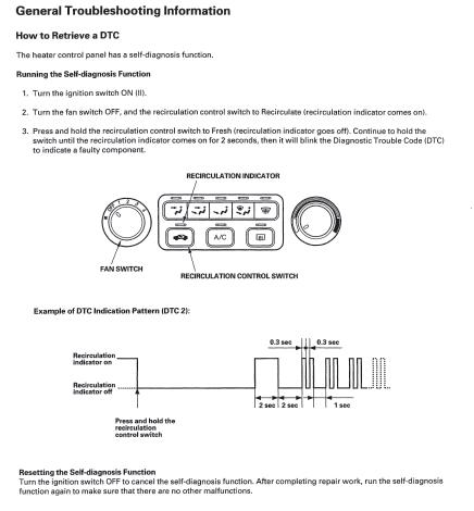

I fixed the problem by adding a wire to the heater control module circuit to bypass one capacitor, because the input voltage of one regulator is too low.
Old Apr 23, 2012 | 06:05 PM
Well if you ever got bored try this........right from the service manual.....but I guess it is wrong . Glad you got it.
EDIT: Section 21, page 4 of the service manual....or did I spend $22 at automanualsource for nothing?
Jim, PA, Texas - Should we add this to the Common DIY Thread ?
Attached Thumbnails '99 Accord LX..A/C Console doesnt work, can't figure it out!!-6th-gen-hvac-dtc.jpg
