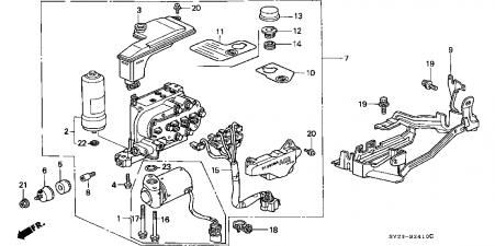

Just out of curiosity.... All of the Honda parts stores online list don't list the #23 o-ring. Any idea of the part number?
Attached Thumbnails ABS Reservoir or M/C on my 94 LX-abs-modulator-461409.jpg

Not sure if this is the right one or not.....57315-ST5-003
See if that comes up as the right one in a search.
