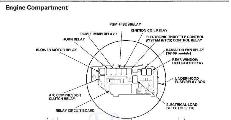

"For the a/c, the next place I would test is at the a/c compressor relay. It is in the fuse box under the hood. If the diagram on the fuse box cover doesn't show the location, let us know, and we will post a picture."

I will need that diagram of the location of the ACC relay as the diagram molded into the underside of the electrical fuse box under the hood is less than clear about 'what' does 'what'.

Old May 10, 2015 | 07:51 AM
See if this helps....

<Borat> Great success!
I popped the cover of the relay & fuse box under the hood and figured out the cute little 'Snowflake' icons were the AC Clutch and AC fan relays.
I swapped them. The AC compressor clutch then worked and the air blew ice cold. The fan did then did NOT run.
I swapped three time to verify function and also cycled the clutch and fan by lightly inserting the good relay into both the fan and clutch sockets.
The relays are Omron G8HL-H71 Made In The U.S.A.
