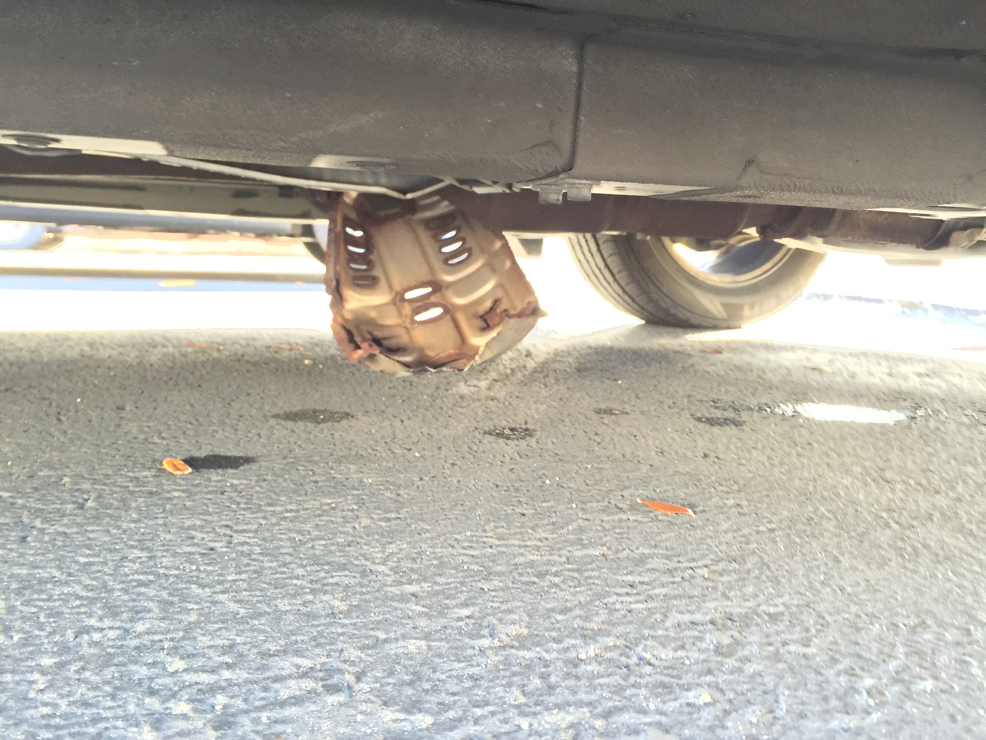

Unhappy Accord underbody coverage fell out
Hi, does anyone know what it is ? looks like a cover for a part.
It's in the middle near front of underbody, fell out yesterday.
thanks,
-Jimmy
Old Mar 6, 2016 | 12:28 PM
That is the lower half of the heat shield that goes around the catalytic converter
Been hearing a "rattle" in the car recently?
Old Mar 6, 2016 | 12:37 PM
jimmylu's Avatar
Joined: Mar 2016
Super thanks poorman212,
I guess I can take that piece off and no need to replace it,
right?
thanks,
-Jimmy
Old Mar 6, 2016 | 01:45 PM
EDIT: For now, yes just get it off......
Well they didn't add it just for no reason.
Ok, a bit if a debate and depends on many factors........ever seen the actual temps that can come off of those, then park over some "somewhat dry grass".....might not be a good day.
Now is it something that "has to be fixed now", no. I would look into having it taken care of as soon as you can.
Again, just my opinion and I'm sure many folks - even some repair shops - will say don't worry about it.
Old Mar 6, 2016 | 06:32 PM
Posts: 16,334
I'll add one other reason to install a new one.
That shield protect the catalytic converter from getting hit by debris on the road. The price of a new converter is well over $500 from Honda.
Old Mar 7, 2016 | 11:43 AM
It looks like the leading edges of that shield are peeled back & damaged by dragging along the ground.
If you catch it sooner, you can usually fasten it back with some amount of clever arrangement of large washers on the mounting bolts, or even some hose clamps.
Old Mar 10, 2016 | 06:35 AM
Bcast23's Avatar
Joined: Mar 2016
I got a plastic bag stuck to mine from the freeway. Eventually got the bag off and had it cleaned. It's 2 months later and it still smells like burning crayons.
Yup, def get that put back on when you get the chance.
