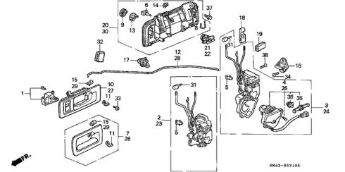

For your car, the power door lock actuator is replaced as a whole with the door latch. Honda discontinued a replacement actuator cover/motor (part #25) years ago.
Attached Thumbnails Actuator Driver side door removal 93 accord-front-door-locks-460264.jpg

Would you mind adding a link from maybe ebay or anywhere so I can see the part that needs replacing? I'm not very familiar with the actuator component, and I don't wanna buy more or less of what I need. not sure what you mean by door latch..
